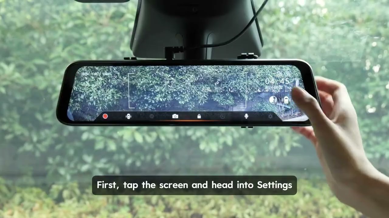

Adjust the "Rear Camera Horizontal Flip" in your settings, or physically rotate the camera lens to achieve the desired orientation.
