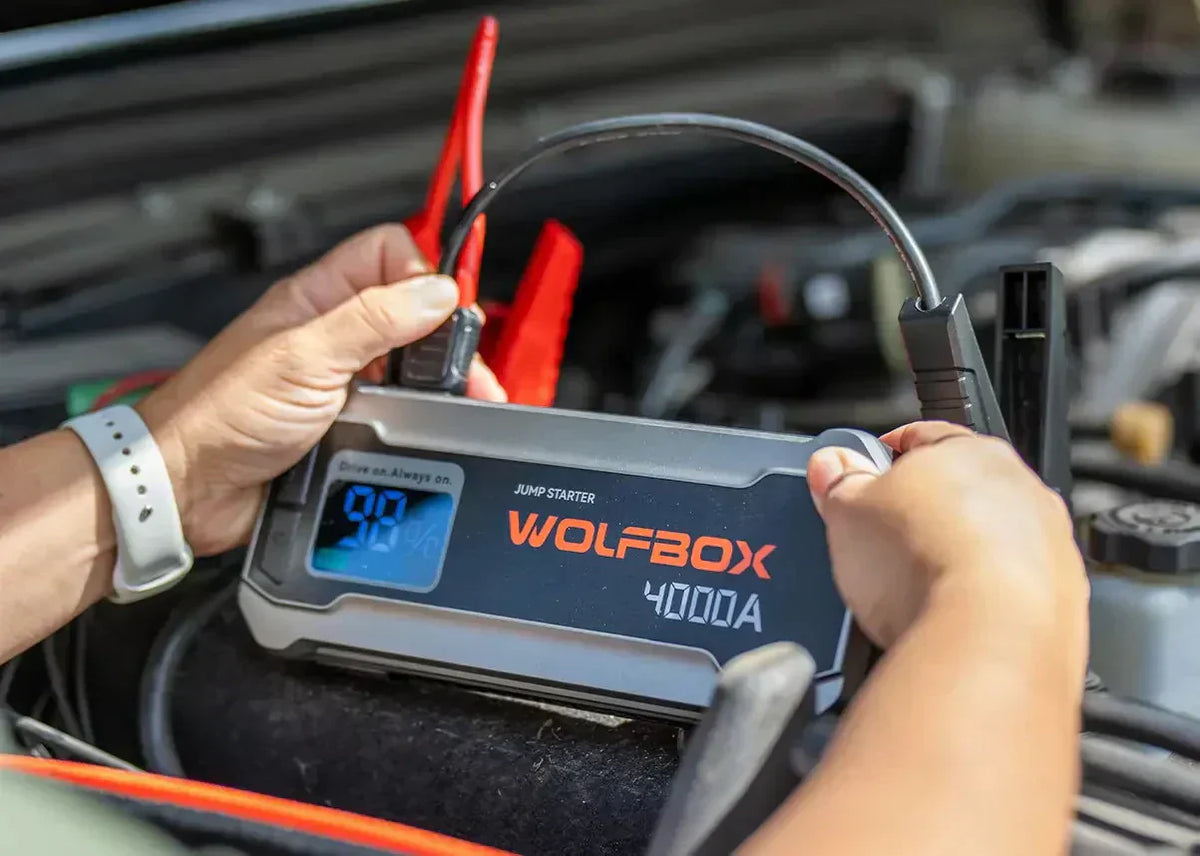

How to Jump a Car Battery with a Jump Starter
Portable jump starters are very handy. You can follow these steps if you want to know how to jump a car battery with a jump starter.
  1. Turn off your car completely.
  2. Connect the red clip to the battery's positive terminal.
  3. Attach the black clip to a metal ground away from the battery.
  4. Turn on the jump starter.
  5. Start your car.
  6. Once you have started your car, you can turn off the jump starter and remove the clips in the reverse way.
If you want something dependable, the Wolfbox Jump Starter is a compact and powerful option that you can keep in your glove box.
